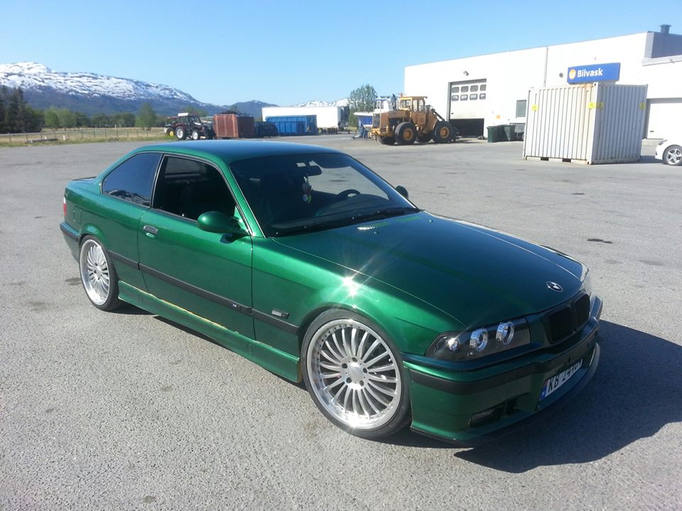

  24. 589b80b3ef5c9_935758_10152246716060639_1633400390_nKopi.jpg.2551611e9e6715f43c24ec89fad4ffc9.jpg
    Gammel bilen, savn :) 318is
