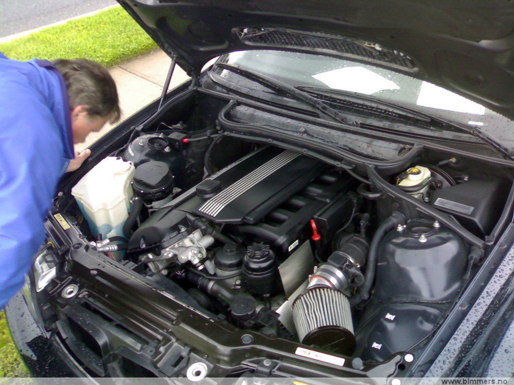

jcvold Skrevet April 15, 2009 Skrevet April 15, 2009 tenkte å ta et oljeskift på min E46 325 og lurer på om det er mulig å nustille den service telleren uten noe spesiaverktøy? noen som vet? bare å tegne og fortele åssen det gjøres da jeg er litt under middels flink å mekke
Richie85 Skrevet April 16, 2009 Skrevet April 16, 2009 jeg bruker carsoft på OBD2, men har hørt det går an å nullstille via displayet.. Mener å huske å ha sett noe sånt på youtube også..
Otis Skrevet April 16, 2009 Skrevet April 16, 2009 Theres another step u can do. depending on your year and not sure what month the car was "built/introduced" RESETTING OIL SERVICE INDICATOR: If your OBC needs to be reset after completing your oil change, there are two ways. NOTE: If you miss a step, just turn the key back off and try again: A. Model Year 1999 to Mid-2000: You should have the older round 20-pin DLC connector under your hood behind the battery terminal, you need to use a small length of wire to connect (short) pins 7 and 19 for 3-5 seconds with the ignition key in position 1 (Accessory). B. After Mid-2000: You should not have the 20-pin DLC connector. You only need to hold the left odometer reset button while turning the key to position 1 (Accessory). Keep holding the button for 5 or so seconds until any of the following shows in the display: OIL SERVICE or INSPECTION with RESET or RE. Release the button and press it again for another 5 or so seconds until RESET or RE flash. While the display flashes, press the button one more time briefly. If done correctly, END SIA should show up for a few seconds. All done.! hope this helps pretty good site. Sakset fra http://www.bimmerfest.com/forums/archiv ... t-404.html Ca midt på siden, litt under.
jcvold Skrevet April 20, 2009 Forfatter Skrevet April 20, 2009 det funket ! den etter mid 2000 versjonen,var ganske lett egentlig takk for hjelpen
