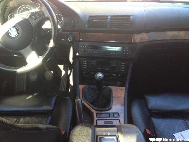

Her er min 1996 528i
post-62210-0-11587700-1391078511_thumb.j
