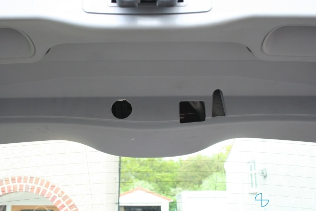

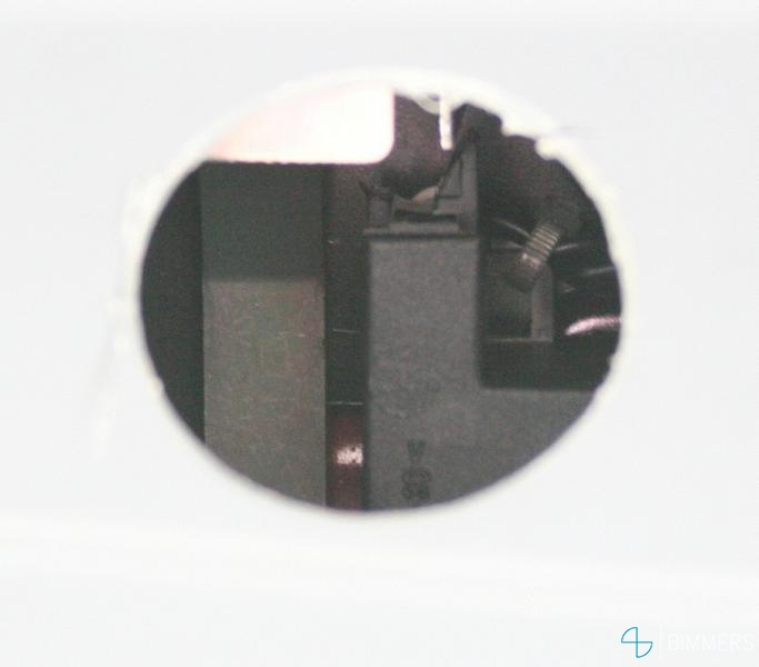

Fant denne på Bimmerfest:
"The lever is actually beneath the trim. The trim cannot be removed properly unless the window (touring) is open. Therefore, if your window won't open, you're screwed!
I was forced to bore an exploratory hole in the trim, beneath the drop down tool tray. Hopefully, If I have done this right, pictures are attached. I will explain:
Picture 1 is a view of the general area. the lid is up and the hole on the RHS is the tool tray hinge hole. The hole on the LHS was bored by me, the centre being precisely 105 mm from the left hand edge of the hingle hole.
Picture 2 is a close up of the new inspection hole. The dark mass on the RHS is black plastic and is the lock mechanism (I think). The band running top to bottom on the LHS is the lever. This is a strong sheet metal strip running from the actuator rod (hidden), to the lock mechanism (hidden). Simply insert a sizeable screwdriver on the RHS of the lever and push it leftwards. It's slow and heavy to move, presumably because of the gearing in the actuator. But suddenly, pop, the window opens.
If any body is crazy enough to repeat this procedure, remember, you can always drill a smaller hole, just enough to get the driver in and feel for the lever. Less of a mess than I caused and it is hidden under the toolbox.
Now, you may be wondering why I took a drill to my BMW, just to open the window. Well, last MOT (UK mandatory test), while checking the car, I found the rear wiper was seized. Frantic repair job prior to test as I knew it would probably fail on that. When the window is closed, there is no opportunity to repair. While the weather is good, I decided to tackle the issue, as I know the wiper will fail again pretty soon. I don't want to be throwing money at a problem with a test deadline in sight, so that is why I did this now. I can now source some replacement parts at my leisure.
By the way, the cause of the window failure was the microswitch button assembly. I was able to find that out after opening the window and without removing the trim.
Thanks for all your interest and replies. Let me know if this isn't clear."
